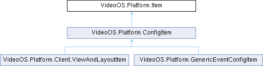

Inheritance diagram for VideoOS.Platform.Item:
VideoOS.Platform.ConfigItem VideoOS.Platform.Client.ViewAndLayoutItem VideoOS.Platform.GenericEventConfigItem
