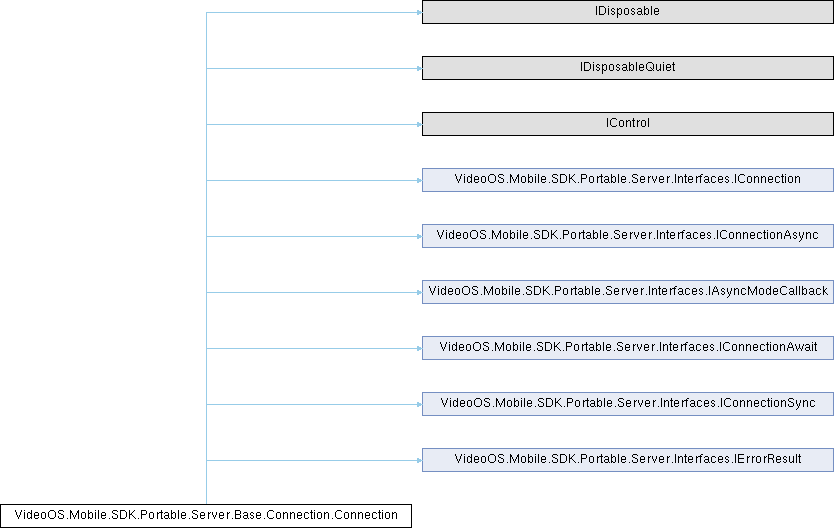

Public Member Functions inherited from VideoOS.Mobile.SDK.Portable.Server.Interfaces.IConnection | |||||||||||||
Public Member Functions inherited from VideoOS.Mobile.SDK.Portable.Server.Interfaces.IConnectionAsync | |||||||||||||
Public Member Functions inherited from VideoOS.Mobile.SDK.Portable.Server.Interfaces.IAsyncModeCallback | |||||||||||||
Public Member Functions inherited from VideoOS.Mobile.SDK.Portable.Server.Interfaces.IConnectionAwait | |||||||||||||
Public Member Functions inherited from VideoOS.Mobile.SDK.Portable.Server.Interfaces.IConnectionSync | |||||||||||||

Properties inherited from VideoOS.Mobile.SDK.Portable.Server.Interfaces.IErrorResult | |
Main class for connection with the 'Mobile Server'.
Class for connection with 'Mobile Server'. Supports 'HTTP' and 'HTTPs' connection types. Could work in sync or asyc mode simultaneously. Should be disposed after finishing work with it. Disposion releases all the resourses and informs server that this connection should be terminated.
