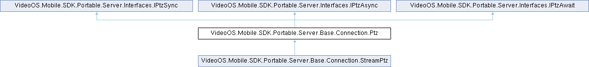

Inheritance diagram for VideoOS.Mobile.SDK.Portable.Server.Base.Connection.Ptz:
VideoOS.Mobile.SDK.Portable.Server.Interfaces.IPtzSync VideoOS.Mobile.SDK.Portable.Server.Interfaces.IPtzAsync VideoOS.Mobile.SDK.Portable.Server.Interfaces.IPtzAwait VideoOS.Mobile.SDK.Portable.Server.Base.Connection.StreamPtz
