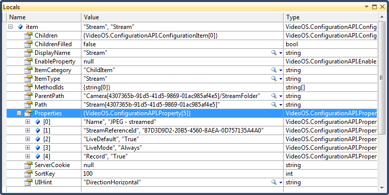

A class that contains information for one item. It may also contain a number of children that are filled or not filled initially depending on what type of item it is.
Typically a ConfigurationItem contains enough information to be displayed in a list or treeview, identify it for further processing and the key properties own directly on this item.
When getting a list of ConfigurationItems, the list will most often not contain any children, indicated by property ChildrenFilled == false. If more detail information is required, a program should recursively iterate through the ConfigurationItems and get missing children.
The ItemType field contains the type of Item, as defined in ItemTypes – for example ItemType.Camera for a camera device.
If the ConfigurationItem is an item that can be disabled/enabled, the EnableProperty will contain a EnablePropertyInfo class with a few detailed fields.
A ConfigurationItem can also be a grouping item. If so, the ItemCategory field will identify it as ItemCategories.Group. This is an internal group and not something you create, but a logical grouping of settings. One sample of this is how the detailed settings for a camera is divided into multiple groups, much like the tabs are constructed in the Management Client.
Figure 1: A ConfigurationItem for a stream definition with 5 properties. The ItemCategory is "ChildItem", so this ConfigurationItem needs to be updated in conjunction with its parent.

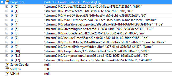

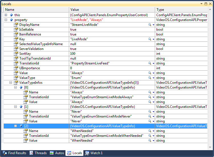

Defines a property and all relevant information needed to display and validate the value content.
The property type is defined by the ValueType, as defined in the static class ValueTypes. The Key field is the identification of the field and the Value field contains the actual value as a string.
For user interface interaction, use the DisplayName for display of a label, the SortKey for sorting the properties, and the UIImportance to identify if this is a normal property, a password property, a hidden property (Check the static class UIImportance for more), and the value should be interpreted according to the ValueType.
The ValueType and ValueTypeInfos combined define how to show and validate the Property.Value.
The Key field can have 2 different formats:
You use the first format for most properties while you use the second format for properties related to specific camera settings.
When you need to identify and find a specific field, use one of the samples to dump a current configuration. Be aware that the properties formatted in the second format can vary from camera to camera and you must be careful handling them if a Key is not available.
Also, in a few places you will have a different referenceId for what looks to be the same property. That can happened for e.g. "Brightness" where this setting on one camera just happens to be different from another camera.
Figure 2: A sample of property content for an Enum property with three possible values.
Figure 3: A sample where the Key fields was generated for one specific camera model, formatted as noted in [2] in the picture above.

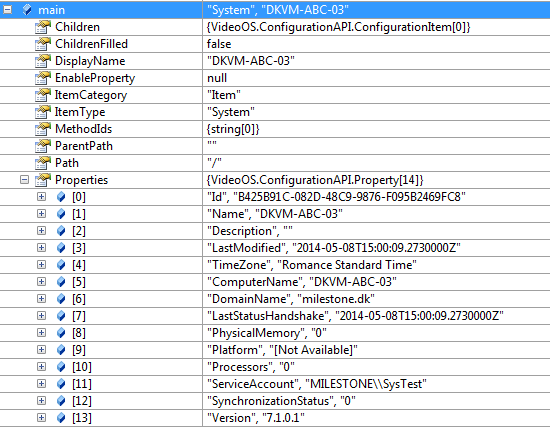

The ConfigurationItem to start with is the one returned by asking for path = "/".
This will return a ConfigurationItem describing the Management Server itself, like:
From here, children are fetched via the GetChildren(parentPath) method call recursive – as deep as it makes sense.

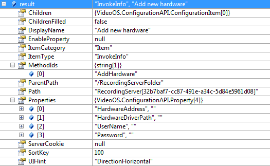

Executing of a method is done on the System Configuration API like:
ConfigurationItem result = client.InvokeMethod(item, methodId);
Where the 'item' is the ConfigurationItem needs to execute 'methodId', for example on 'RECORDER-25' execute 'AddNewHardware'. Note that no parameters are present at this point, it comes in next step.
The result describes the result of the execution of the method. If the MethodId requires parameters, then the result will be a ConfigurationItem with ItemType == InvokeInfo.
Figure 4: ConfigurationItem with ItemType as InvokeInfo
The Properties contain the parameters needed to perform the server side method.

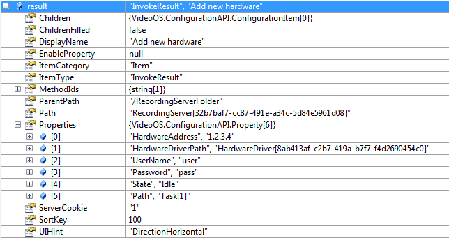

The client application should now fill the Value field on these properties and issue a new client.InvokeMethod(result, result.MethodIds[0] ).That will then again ask the server to execute the first method on the ConfigurationItem returned by the initial call.
Note that there might be multiple MethodIds available such as "Back" or "Skip" or "Next".
Figure 5: ConfigurationItem with ItemType as InvokeResult.
Now the resulting ConfigurationItem has ItemType == InvokeResult. This means that the server has initiated and perhaps completed the executing. In the above sample, it was a MethodId for adding new hardware, and the server creates a server side task to perform this.
When the ItemType is InvokeResult, the properties are identified by the keys defined in the static class InvokeInfoProperty:
