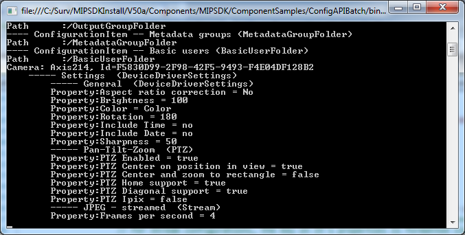

The ConfigAPIBatch sample reads through parts of a configuration and dumps key ConfigurationItems and their properties.
Server name, user name and password are hardcoded in the sample, so these must be changed before running it.
The sample demonstrates
- How to navigate through the hierarchy of ConfigurationItems
- How to find specific properties, for example the FPS for cameras
