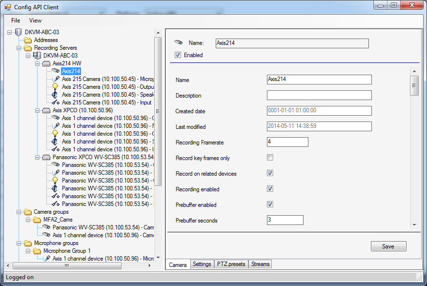

The sample uses the logon dialog to login to an XProtect server via the ServerCommandService, and uses the Configuration API for getting all configuration and performing the changes done by the operator.
Shows a treeview on the left hand side, and the content of the selected item on the right hand side.
