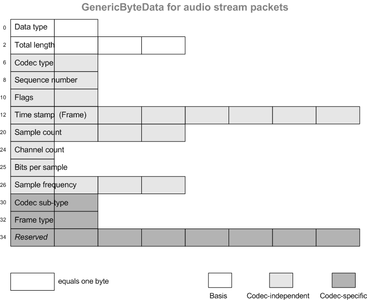

The audio stream packet sub-format defines an encapsulation of audio data much in the same way as defined for the video stream packet with a few differences due to the difference in media type; one being that an audio stream packet represents an audio frame with potentially more than one channel of audio data. All audio frames are currently defined to be individual of each other, and they can therefore be compared to the SYNC points defined for the video stream packets. The sub-format header is shown in the figure below. The header layout is fixed, and its length is fixed to 42 bytes. The interpretation of the different header fields is given in the following.
Illustration of the sub-format header for audio stream packets.
- 'Data type'
- The data type is fixed to a value of
0x0020for the audio stream packet sub-format. No other value is used to indicate this sub-format. - 'Total length'
- This header field contains the total length in bytes of the entire audio stream packet. The length includes the length of the full header (including this and the previous header field), so the actual length of encapsulated audio data is found by subtracting the header length (42) from the given value. This also means that the value in this field will be at least 42. The field is an unsigned 32-bit value, which means that no single audio packet can be longer than (2^32)-1 bytes.
- 'Codec type'
- This 16-bit unsigned value indicates the audio codec type of the encapsulated data. It thus also determines the exact interpretation of the last reserved header bytes. The currently defined values for codec type is given in the table below.
- 'Sequence number'
- This unsigned 16-bit value indicates a sequential number for the given packet. The number increases by one with each packet in the sequence (stream). The sequence number wraps at
0xFFFFto restart at0x0000for the next packet. The start value of the sequence number as the stream begins is arbitrary , and although it may often be0x0000that cannot be relied on. The sequence number can be used e.g. to check for losses of audio stream packets. - 'Flags'
- This 16-bit wide header field contains a number of codec-independent bit-flags. The bit-flags are currently reserved for future use, as no flags have been defined yet.
- 'Time stamp (Frame)'
- This header field is represented by an unsigned 64-bit value that indicates the absolute time stamp of the audio frame. Similar to what is defined for the video sub-formats, the stored time stamp value is given as the absolute number of milliseconds since the Unix time epoch in UTC. The time stamp is the absolute time of the first audio sample of the audio packet. As the precision of the indicated time stamp is in milliseconds, the time stamp may not be sufficiently precise to indicate the start time stamp exactly depending on the audio frame length and the sampling frequency. In practice, this should have no influence on the handling of audio stream packets.
- 'Sample count'
- This header field is an unsigned 32-bit value that represents the number of audio samples per channel in the audio data (frame). The sample count is the number of uncompressed (decoded) samples so this number does not represent the number of compressed samples for the codecs where such an interpretation is applicable (although often the number of compressed and the number of uncompressed samples will be equal).
- 'Channel count'
- This header field is represented by a single byte and indicates as an unsigned value the number of audio channels that are in the given packet data. The maximum number of channels is limited to 255, and the number must not be zero. In practice, only a few channels is supported by the system.
- 'Bits per sample'
- This header field contains as a single unsigned byte the number of bits per sample (per channel). The value represents the number of bits in an uncompressed and decoded sample, and thus does not provide the number of bits used to represent the coded/compressed data (which may be a variable number of bits per sample). Although the allowed range is from 1 to the maximum of 255, the set of typical values is very limited, e.g. 8 or 16. A value of zero is not allowed.
- 'Sample frequency'
- This header field is represented by 32 bits as an unsigned number providing information on the sample frequency of the each channel of the (uncompressed) audio data of audio packet. The sample frequency is given in Hz so that for example a sample frequency of 8 kHz is stored as a value of 8000. A value of zero is not allowed. Although the range of possible values is large, the typical subset of frequencies actually used is small.
- 'Codec sub-type'
- This header field is codec-dependent, i.e. its interpretation depends on the actual codec type given in the 'Codec type' header field. It is used to provide information on different sub-types of the codec. This is detailed later for each supported codec. If not used by a given codec, the value must be equal to the default value being
0x0000. - 'Frame type'
- This header field is codec-dependent, i.e. its interpretation depends on the actual codec type given in the 'Codec type' header field. It is currently not used by any codec, and its interpretation is thus considered reserved for future use. It must be equal to the default value
0x0000. - 'Reserved'
- The last 8 bytes of the header are reserved. The information contained within these bytes are considered to be dependent on the actual codec of the encapsulated data as given by the 'Codec type' header field. The interpretation of this header field is reserved for future use. All 8 bytes of the header field must be zeroed, i.e. equal to
0x00.
