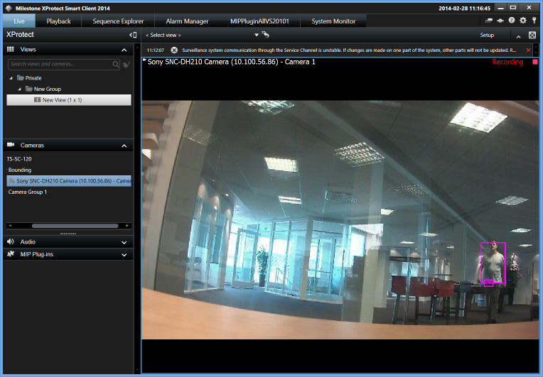

A bounding box is a box that surrounds an interesting feature of the video or image. The “interesting feature” can for example be motion, face recognition, number plate, anomalies, etc.
The bounding boxes are often the result of an automated analysis of the video, and are used to draw attention to an interesting feature that the analysis discovered. One of the simplest forms of usage is to draw bounding boxes around areas in the video where there is motion. Figure 1 shows an example of bounding boxes around areas showing motion.
XProtect Smart Client has built-in support for displaying bounding boxes encoded in an ONVIF Metadata stream. The format is described in the section Bounding box

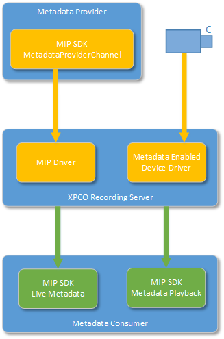

This section gives an overview of how the MIP Driver and MIP SDK components support metadata.
As Figure 2 shows, support for metadata consists of three major parts. These parts mimic video support closely:
- Producers of metadata can be hardware devices (usually cameras), or analytics services that uses the MIP SDK to send data to the XProtect VMS.
- A recording server stores the data (if recording is enabled), passes it on to live consumers, maintains data retention, and runs the drivers.
- The consumers can be stand-alone applications, integration solutions or XProtect Smart Client plug-ins. The XProtect Smart Client supports bounding boxes out-of-the-box.

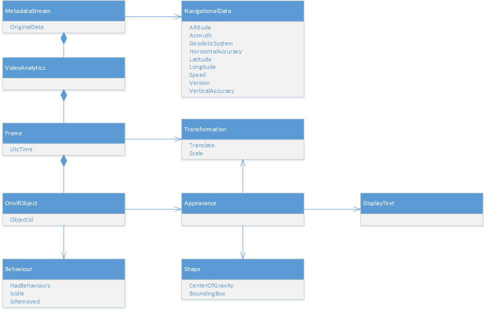

The Milestone MetadataStream classes
The class VideoOS.Platform.Metadata.MetadataStream supports reading and writing an ONVIF MetadataStream payload.
A number of related classed make it easy to access a subset of the elements in the MetadataStream schema. These classes – shown in Figure 9 – are also used internally in Milestone.
VideoOS.Platform.Metadata classes. A few minor classes have been omitted.You can, of course, create and parse the MetadataStream payload any way you see fit.

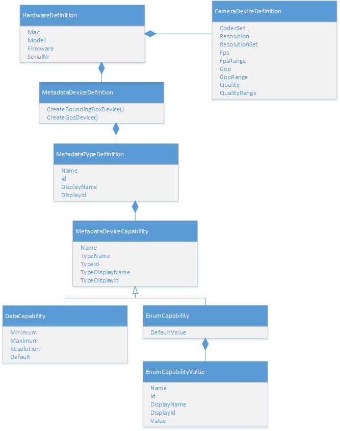

As the code example indicates, the first step is to create a description of the pseudo-hardware. This is the responsibility of the HardwareDefinition class. This class takes two required parameters in the constructor: A name for the device, and a MAC address. This MAC address is not related to the host where the application runs; it is used as an identifier for the device. After this, a single metadata device is configured by using a convenience method to configure a device that delivers GPS data. With this definition in hand, it is now possible to create an instance of MediaProviderService. The Init method takes a port number where the instance accepts connections from the MIP Driver, a password used when adding hardware, and the definition of the hardware.
var hardwareDefinition = new HardwareDefinition(
PhysicalAddress.Parse("001122334455"),
"MetadataProvider")
Firmware = "v10",
MetadataDevices = { MetadataDeviceDefintion.CreateGpsDevice() }

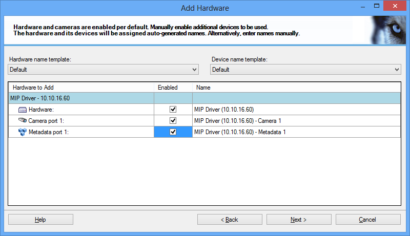

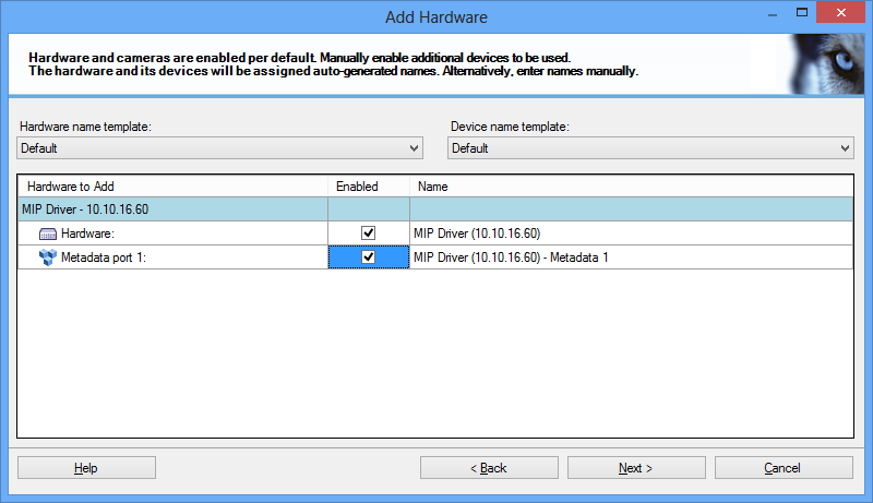

After the call to the Init method, you can now add the device to the XProtect VMS by using the supplied port number and password. When the hardware has been added, it looks like Figure 10
When you have called the Init method, the next step is to create a channel where data can be sent. It does not matter whether you create this channel before or after the hardware is added to the XProtect VMS. Provide the correct channel number when creating a channel, in this case 1. If there are multiple devices defined in the hardware definition, it is up to the client of the SDK to keep track of which channel corresponds to which metadata device.
The channel has a couple of events that provide information on whether a driver has established a session to the application or not. There can be several sessions open simultaneously. The last step is to send data to the XProtect VMS as shown in Figure 12.

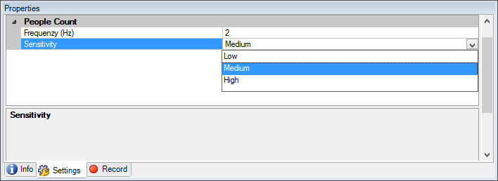

If you choose to define your own metadata types and configuration options, Figure 16 shows an example of how to define a metadata type called People Count
. This metadata type has two configuration options, where the first is frequency that takes on an integer value, and an enumerated option called sensitivity that has three possible values. When this device is added to the XProtect VMS, the XProtect Management Client shows the options displayed in Figure 17.

When defining the hardware, you need to set a number of GUIDs and names. The GUIDs serve two purposes: One is for localization, and the other is for grouping. All the GUIDs that contain "Display" in their property name are used for localization purposes, whereas the others are used for grouping. This means that for example MetadataTypeDefinition.Id uniquely defines the type of metadata. If developers wants to have for example "People Count" to be the same type for different devices, they must use the same GUID for the type definition so that they can be grouped. If localization is not relevant, any GUID will do. The same goes for groupings: If it does not matter whether the types are the same, any GUID can be used.
In general, please contact support to get new GUIDs and names for new types. If you just want to experiment, you can use your own GUID values, names, and display names. However, if you deploy software with your own names and GUIDs, localized display names are not available.
