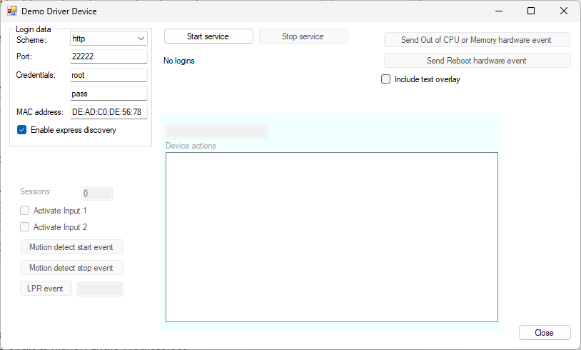

- Run
mipsdk-samples-plugin\Simulators\DemoDriverDevice\bin\debug\DemoDriverDevice.exeas administrator.
- By default, the device will use the credentials
root:pass, the scheme ‘http’, the port22222, and the MAC addressDE:AD:C0:DE:56:78. Specify the desired port, MAC address, and credentials, and then select the Start service button. - In the Management Client, use the Add Hardware... wizard with the Manual method to add the Demo Driver device to your recording server. The Demo Driver is found in the driver list in the Other group.
