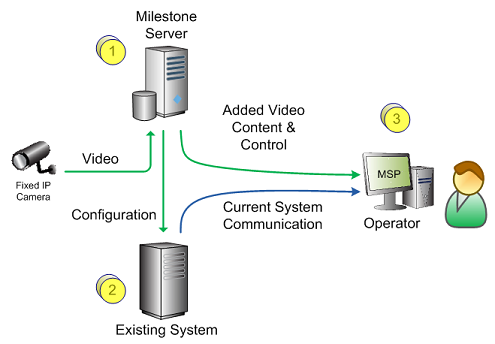

Adding video content to an existing application
An existing system with a well-known user interface needs to expand with video content to the user interface.
Description
This system could be an HTML-based client for access control management, a retail statistics application or a transportation overview and status application.
1) Milestone server
- No further development.
2) Existing system
- The Milestone configuration is retrieved, and an application that can link cameras and existing system devices is developed.
- A method for sending relevant camera IDs to the client is developed.
The base line for these systems is that they all have an existing system where operators are handling some kind of events and alarms and would like to add video for further clarification, identification, or documentation of incidents.
