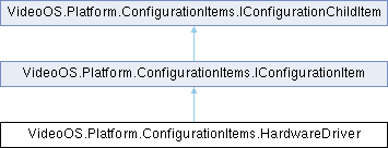

Inheritance diagram for VideoOS.Platform.ConfigurationItems.HardwareDriver:
VideoOS.Platform.ConfigurationItems.IConfigurationItem VideoOS.Platform.ConfigurationItems.IConfigurationChildItem
