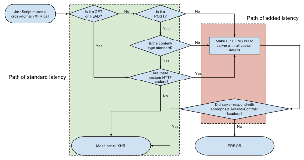

There is a mechanism on every browser which prevents calling an http request to a server which is different than the one that hosts the application. This restriction is called Cross-Origin Resource Sharing (CORS).
To allow this, you must open and edit the configuration file on the mobile server named VideoOS.MobileServer.Service.exe.config. Find the line containing the following key: Access-Control-Allow-Origin and change its value to the host which servers the JavaScript SDK (for example: http://hostname:port)
You can also use wildcards (*) to allow this for every hostname.

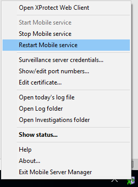

The other security mechanism set in the mobile server is called Content Security Policy (CSP). This policy prevents the arbitrary user from stealing data from the mobile server. To remove it, you can set the key: Content-Security-Policy value to empty in the mobile server configuration file:
After making these changes, you must restart the mobile server, so that the changes are applied.
