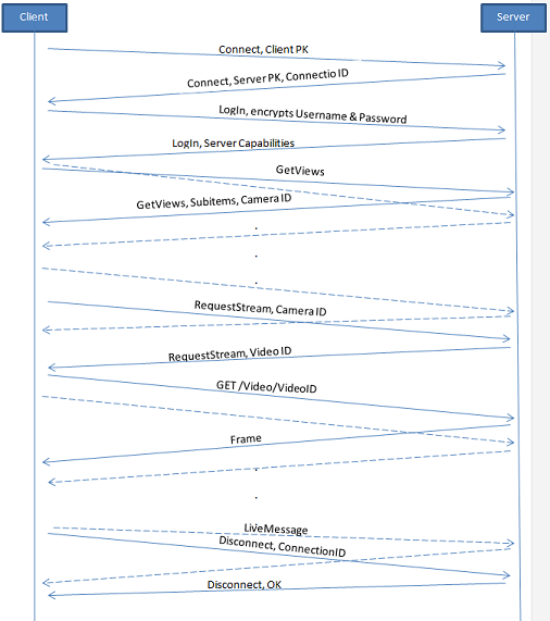

Communication flow
A typical flow of requests and commands looks like this:
