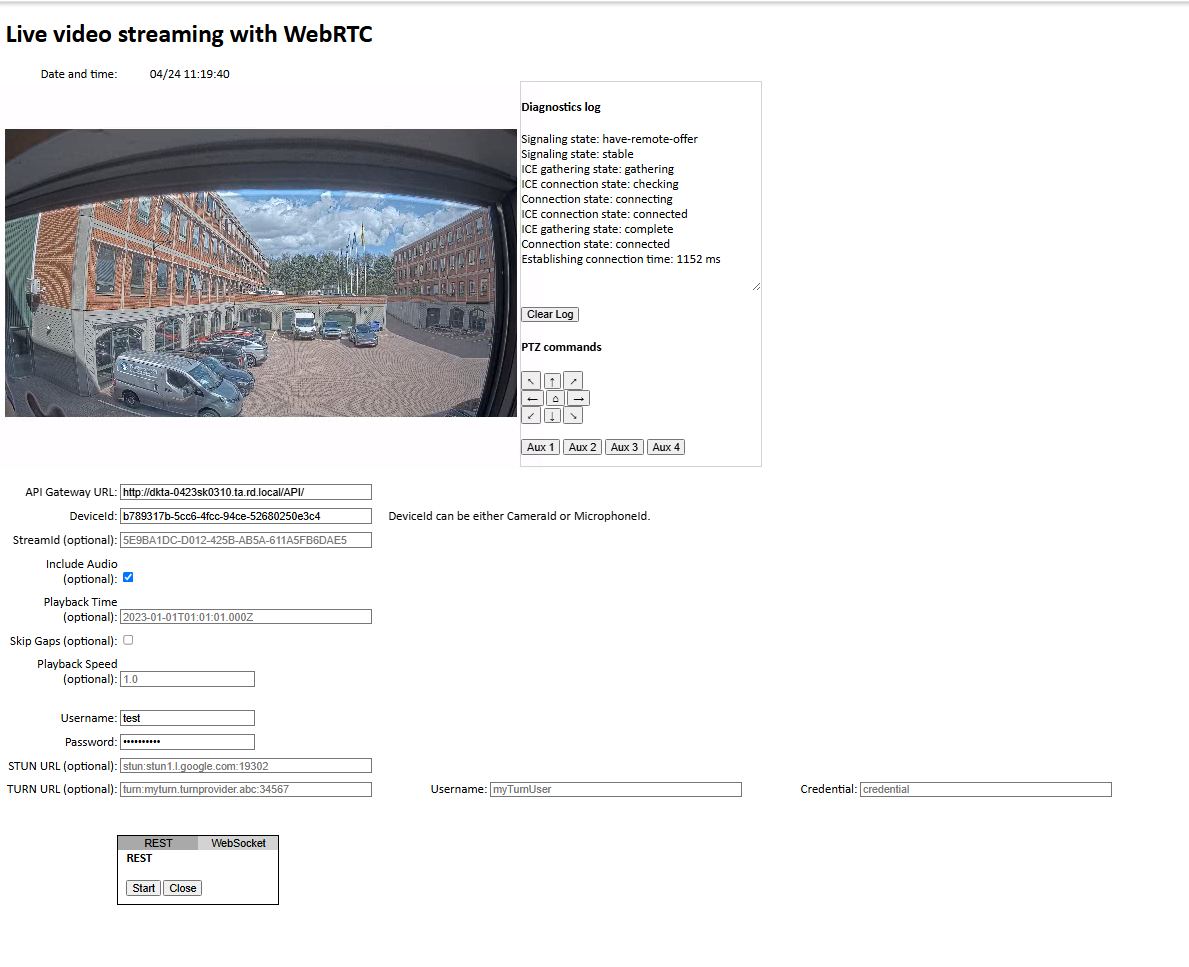

Running
- Open
index.htmlin a browser - Enter the URL of the API Gateway.
Usually, the API Gateway is installed on the same host as the management server, that is, the API Gateway will be something likehttps://managementServer.example.com/api. - Enter the DeviceId. Supported device types are
camera with H.264 support or a microphone.
See Get a DeviceId. - Optionally, enter a StreamId. See Get a StreamId.
- Optionally, deselect Include Audio. See Audio stream.
- Optionally, enter an ISO 8601-formatted datetime string in Playback Time to request video playback instead of live video.
- Optionally, select Skip Gaps to skip gaps between video sequences in video playback.
- Optionally, enter a number in Playback Speed. The default is 1.0, and any value > 0 and ≤ 32 is valid.
- Enter Username and Password of a basic user with access to the camera.
- Optionally, enter a STUN server address, for example
stun:stun1.l.google.com:19302. - Optionally, enter a TURN server address, username, and credential (password).
- Select signaling protocol. Default selection is REST, See Signaling protocols.
- Select Start to establish the connection.
