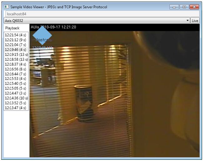

This sample shows how to utilize the Image Server protocol to retrieve a sequence of images.
The application logs in to the server you specify and lets the user select a camera from a dropdown.
A list of recorded sequences are displayed on the left. When you select one, the relevant sequence of video will be shown.
The sample demonstrates many of the key XML elements used on the Image Server protocol. The sample also shows the protocol differences between viewing in live mode and when retrieving recorded images.
