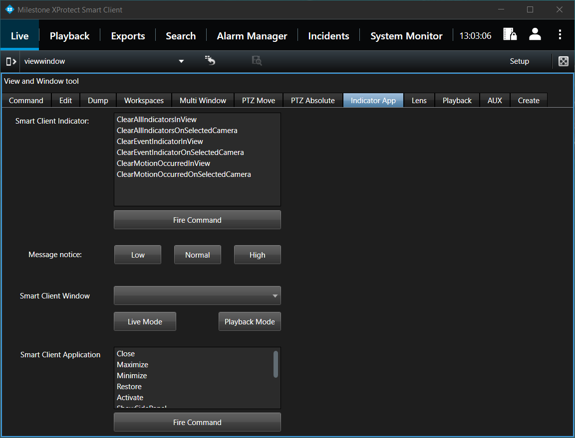

Smart Client View and Window Tool
This sample includes areas that show most of the messages supported in the Smart Client.
The areas are divided into tabs:
- Command - Controlling options for a view
- Edit - How to edit an existing view layout
- Dump - Shows a tree view with all known views
- Workspaces - How to work with workspaces
- Multi Window - How to work with floating windows
- PTZ Move - Controlling cameras
- PTZ Absolute - How to get and set / go to a specific absolute position
- Indicator & App - Smart Client application control
- Lens - Commands that can be sent to a camera
- Playback - Smart Client playback control via programming
- AUX - Extension to PTZ control for specific devices
- Create - How to create a new view layout and assign views
The selected tab shows that 6 messages can be sent to control the indicators in view or selected camera, and several messages to control how certain Smart Client parts should appear.
