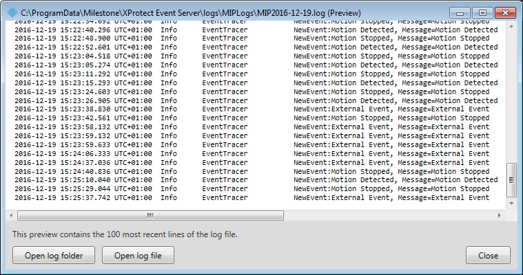

The Event Tracer tool plug-in will listen for new events in the XProtect Event Server and upon receiving information on the event it is written to the log of the event server.
The plugin will when running write to the Event Server's MIP log every time an event happens.
The MIP log of the Event Server seen using the Event Server Manager's "Show MIP logs" function.
