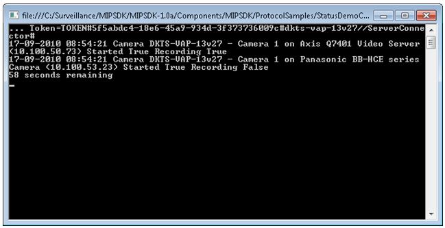

This sample shows how to access the Status API to retrieve status and events from the system.
The sample is a console application to make the code as simple as possible, while still demonstrating the key access methods.
The application takes the name of the XProtect Management Server as an argument on the command line. It will initialize the VideoOS.Platform.SDK environment, log in to the Management Server and then identify one random recorder in the configuration.
When connecting to this recorder, the application will create a list of all events and cameras for any event from or relating to any of these.
The application will dump any state changes and events that occur while the application is running.
