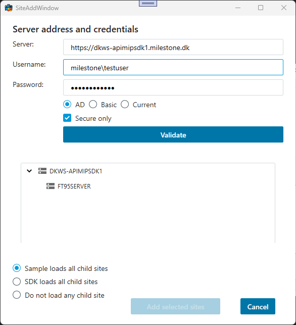

The above dialog adds a site and potentially all child sites known by this site using Windows AD authentication.
Here we see the same dialog after having used the Validate button.
The options for adding child sites:
- Include all child sites now: Will add all child sites during the add process
- Delay include all child sites: Will wait to include until needed, in this sample by the ItemPicker
- Do not include any child sites: Will only add the site selected

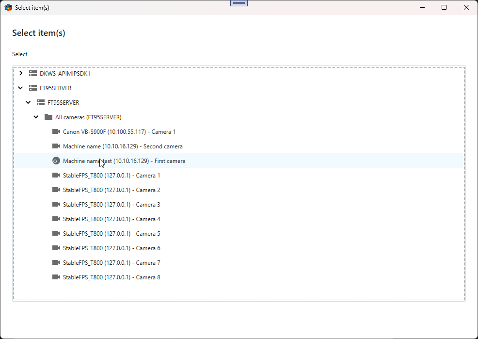

After the login to the above two XProtect systems, all cameras and other known items are available for selection, as can be seen from the above ItemPicker dialog.
