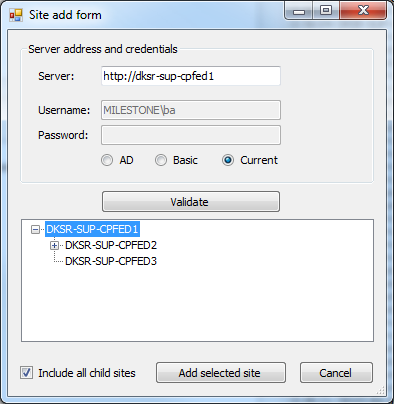

When adding an XProtect site you can automatically add the child sites. There is no limit to how many systems or sites you can add.
To use it click the add button and put in server address, username and password in the “Site add form dialog”.

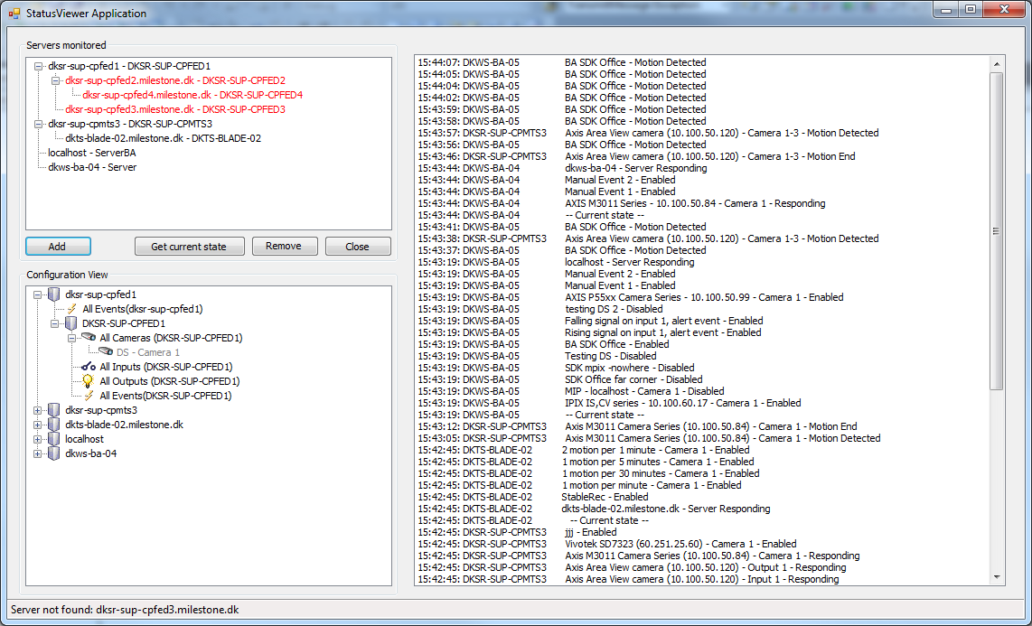

With many sites added it might look like this:
Remove button is used to remove a site again.
When a site is started the current state of the system is communicated, this can be repeated using the Get current state button.
