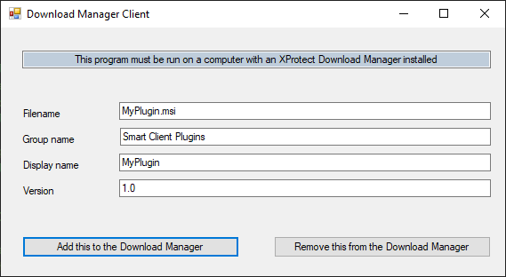

Run the sample as Administrator. The following dialog is displayed:
Even though we don't have a 'MyPlugin.msi' installer file in this sample, we can still press the Add this ... button and will see this dialog:

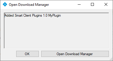

Press OK:
The dummy text file has been added to the download page.

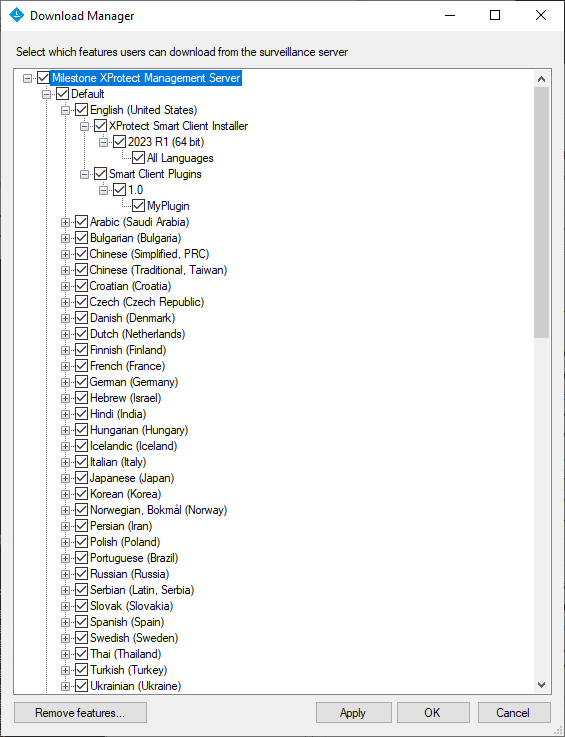

Further maintenance can be done in the Download Manager application. This tool can be started by clicking on Open Download Manager button, or by selecting it in the "Start > Milestone > XProtect Download Manager".
In Download Manager application you can remove and add features available for download. If you deselect a program or feature, it will remain installed on the server, but not available for download.

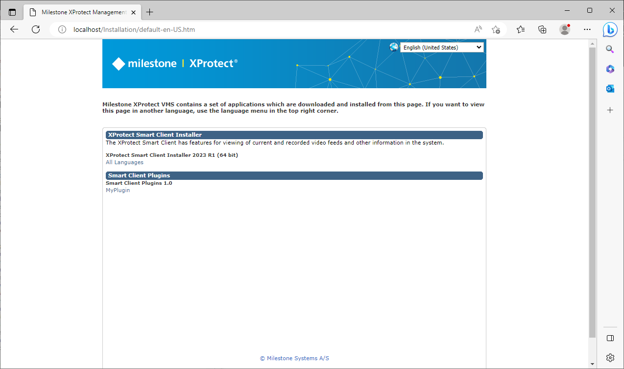

The http://localhost/installation page would now look
like this:
