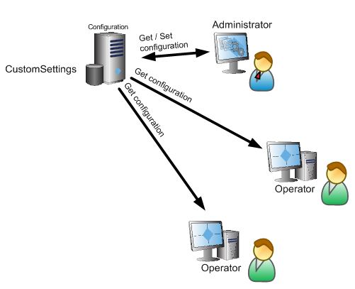

Illustration below shows a configuration stored on video server.

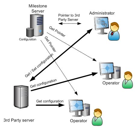

Illustration below shows a configuration on remote third-party server.
