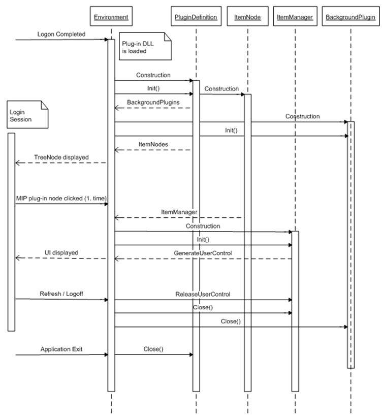

Class Life Cycle – Administrators
The life cycles of each of the main classes are illustrated below. The bar under each class name illustrates the period in which the class exists.
To start with, only the PluginDefinitions and the BackgroundPlugins are constructed and initialized. The ItemNode is expected to be constructed in the PluginManager's Init() call. The ItemManager is initialized the first time it is required.

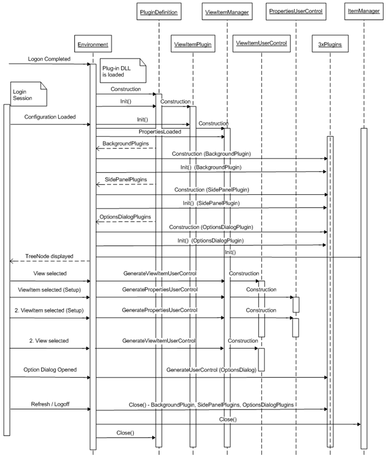

Class life cycle – Smart Client
The life cycles of classes in the Smart Client are illustrated below. Almost all plug-ins are constructed and initialized during the login process.
The ViewItemUserControls and the PropertiesUserControls are generated and disposed as the user selects different views or selects different viewitems in one view during setup mode. Note that one ViewItemManager holds the configuration for a viewitem position.
If multiple floating windows are opened with the same view, there is still only one ViewItemManager, but multiple ViewItemUserControls. The refresh process is not illustrated below, but it basically callis the Close() on all plug-ins, and Init() again after the new configuration is in place.
