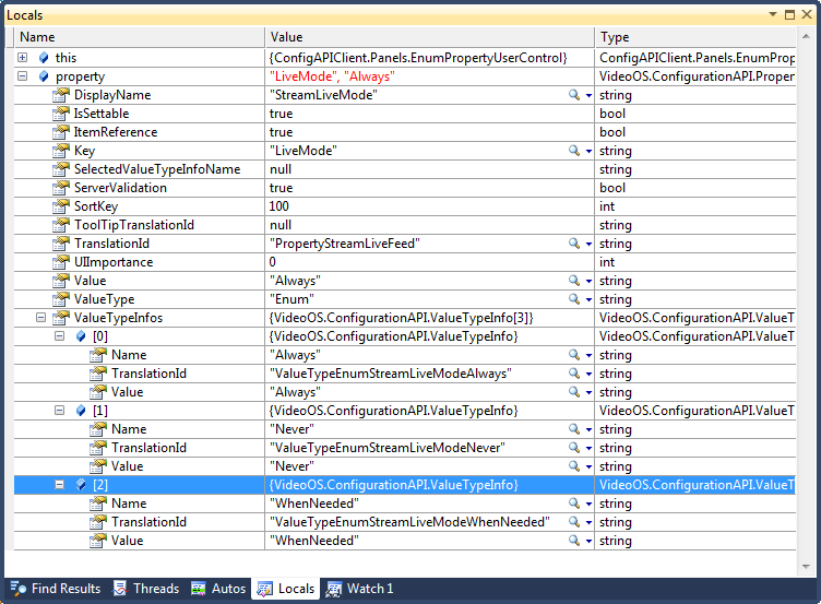

                    Property
Defines a property and all relevant information needed to display and validate the value content.
The property type is defined by the ValueType, as defined in the static class ValueTypes. The Key field is the identification of the field and the Value field contains the actual value as a string.
For user interface interaction, use the DisplayName for display of a label, the SortKey for sorting the properties, and the UIImportance to identify if this is a normal property, a password property, a hidden property (Check the static class UIImportance for more), and the value should be interpreted according to the ValueType.
The ValueType and ValueTypeInfos combined define how to show and validate the Property.Value.

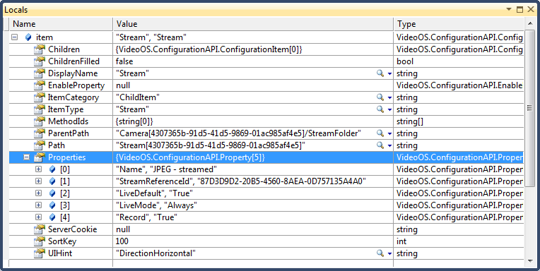

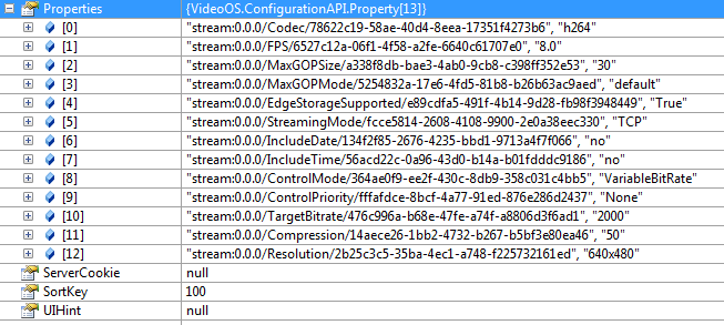

The Key field can have 2 different formats:
- A single string with a readable name, for example "Address"
- A combined string of streamId/name/referenceId
You use the first format for most properties while you use the second format for properties related to specific camera settings.
When you need to identify and find a specific field, use one of the samples to dump a current configuration. Be aware that the properties formatted in the second format can vary from camera to camera and you must be careful handling them if a Key is not available.

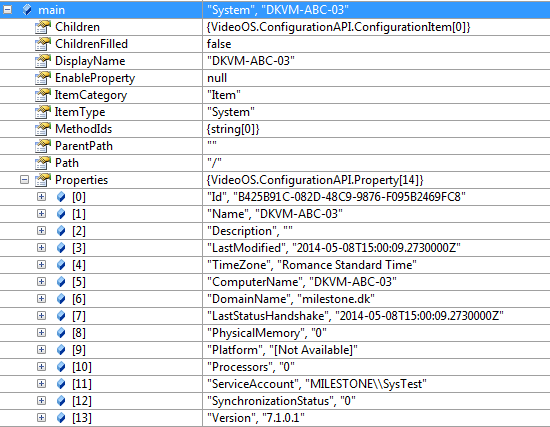

The ConfigurationItem to start with is the one returned by asking for path = "/".
This will return a ConfigurationItem describing the Management Server itself, like:
                    From here, children are fetched via the GetChildren(parentPath) method call recursive – as deep as it makes sense.

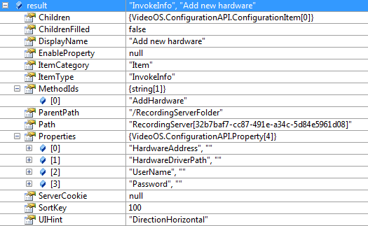

To perform server side functions, methods are used. The idea here is that the server will own construction of all new items, their properties and all built-in class properties. This is to ensure that not all client applications need to understand every little detail each system might have, in regards to properties and their default values.
All add, remove and construction of child items is done on the server side.
All the methods known by a specific server, are defined in the result returned by GetMethodInfos() on the System Configuration API.
As methods are ‘executed’ on a specific ConfigurationItem, each ConfigurationItem defines what methods are valid in its MethodIds array.
Executing of a method is done on the System Configuration API like:
ConfigurationItem result = client.InvokeMethod(item, methodId);Where the 'item' is the ConfigurationItem needs to execute 'methodId', for example on 'RECORDER-25' execute 'AddNewHardware'. Note that no parameters are present at this point, it comes in next step.
The result describes the result of the execution of the method. If the MethodId requires parameters, then the result will be a ConfigurationItem with ItemType == InvokeInfo.
                The Properties contain the parameters needed to perform the server side method.
The client application should now fill the Value field on these properties and issue a new client.InvokeMethod(result, result.MethodIds[0] ).That will then again ask the server to execute the first method on the ConfigurationItem returned by the initial call.
