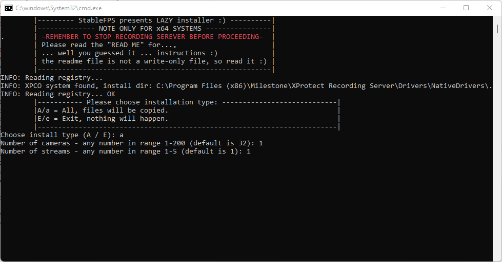

When the installation has successfully completed, you will find StableFPS files at%ProgramFiles%\Milestone\MIPSDK\Tools\StableFPS\ - Stop the Recording Server service.
- Run
%ProgramFiles%\Milestone\MIPSDK\Tools\StableFPS\InstallStableFPS_EXTERNAL.batas Administrator. - Answer the prompts. Number of cameras running in one hardware device on same settings, and number of streams for each camera.
- Start the Recording Server service.

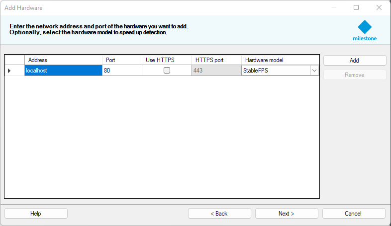

Now you can add simulated test cameras:
- In Management Client, find the recording server and run the Add Hardware wizard
- Select Manual mode
- Username and password is not used for StableFPS, no entry is required
- Clear all driver selections and select Milestone > StableFPS driver.
- In Address enter
localhostor the recording server IP. - In Hardware model pick StableFPS (Auto-detect won't work).
- Complete the wizard as usually for adding cameras.
