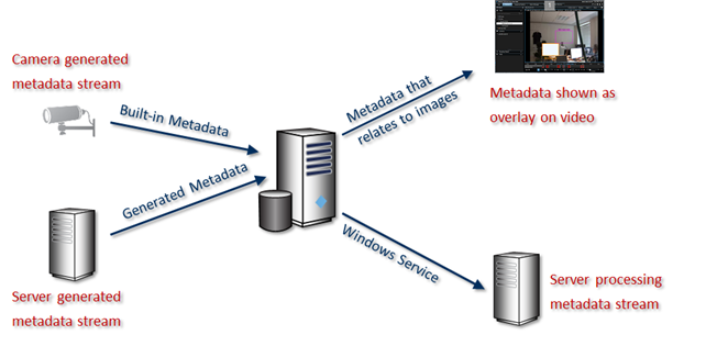

Following is an overview of the system architecture and where to integrate a metadata provider or a metadata consumer with Milestone XProtect video management software.
The drawing below shows different ways of providing metadata to Milestone XProtect video management software or using metadata from Milestone XProtect video management software.
