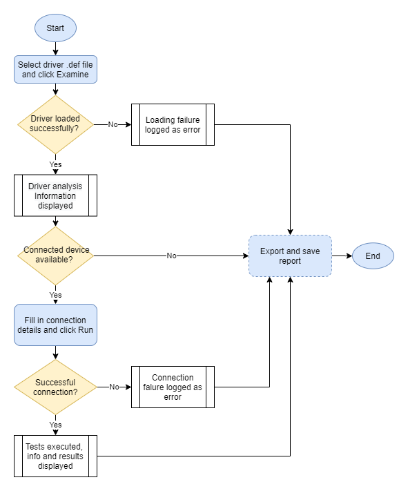

The driver test workflow consists of these steps:
Start the 3rd Party Driver Test Tool
Select a driver, and load and analyze the driver device definitions.
Run dynamic tests of driver functionalities with a connected device.
Export the gathered information and logs into a report file.

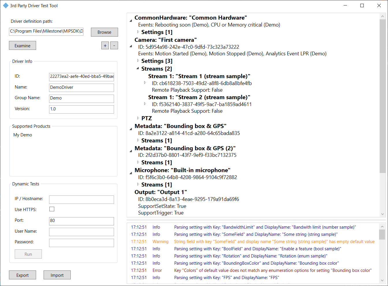

After the driver has been loaded successfully, the tool fills in the Driver Info and Supported Products sections, as well as the Logs section.
Any inconsistencies found during the analysis phase are logged as either Warnings or Errors, depending on their severity.
Driver Overview section
Each Driver Device tree in the Driver Overview section is a direct representation of a single DeviceDefinition instance in the driver. The structure depends on the device type and defined capabilities.
Here is a formal description of the structure of each Driver Device tree as seen in the tool:

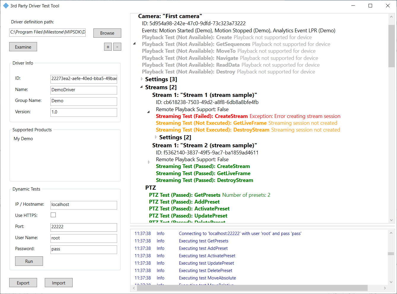

To start the tests, fill in valid connection info (IP/Hostname, Port) and credentials (User Name, Password) for the connected device in the Dynamic Tests section and click Run.
Test info and results
The tool displays the test info lines directly below the tested device/capability in the Driver Overview section.
Each test info line has the following format: TestType (Result): TestName AdditionalInfo
- TestType - Based on the Manager class
- Result - Outcome of the test
- TestName - API method
- AdditionalInfo - Information relevant to the Result
There are four types of test results:
Passed - No exceptions have been thrown and the result (if any) returned by the method is valid.
Failed - An exception has been thrown, a method returned an invalid result, connection has been lost, or a required method has not been implemented in the driver.
Not Available - The functionality verified by the test is not enabled. The tool does not execute the test, but shows that the test is applicable for the device/capability under different circumstances.
Not Executed - The tool does not execute the test because some prerequisites are missing. E.g. a previous test has failed, and the current test depends on its successful passing or return value.
If the initial connection to the device fails, the tool does not attempt to execute the tests. Instead, it logs an Error with the reason for the failed connection. The Error log is based on the information returned by the driver, e.g. authentication error.

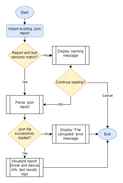

Click Import to select and open a .json report file.
On successful import, the tool visualizes the report data identically to a just loaded driver, with or without dynamic test execution information, along with all saved logs.
The imported report is read-only and cannot be modified or exported.
If the report was created with a newer or older version of the 3rd Party Driver Test Tool, a warning message appears on Import. You may choose whether to continue loading the report or cancel.
- "This file was exported by a different version of this tool (<report_version>). The current version is <tool_version>. There may be missing or misleading information shown. Continue?"
In case of a corrupted report file, the tool stops loading the report and issues an error:
- "File is corrupted!"
