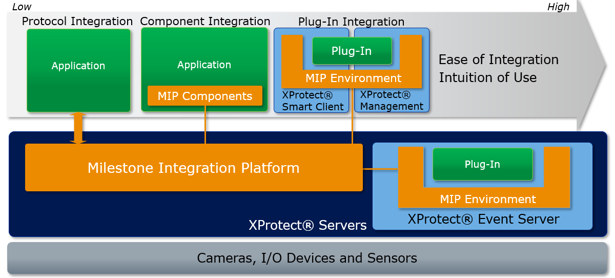

The MIP SDK includes a suite of protocols, components, and plug-ins facilitating integration.
This table gives you an overview of the advantages and disadvantages of the different types of integrations.
| Integration type | Advantages | Disadvantages |
| Protocol | Operating system- and development environment-agnostic. Can enable high performance. | High complexity and low developer output. |
| Component | Easy development of new applications. Easy integration into 3rd party application. | Requires .NET environment. |
| Plug-in | Fast development of functionality without the need to build the hosting environment. Direct integration inside Milestone’s clients. | Requires .NET environment. |
