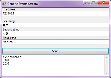

The following screenshot shows the UI.

- How to send a stream of characters encoded as UTF-8 to the XProtect Generic Event interpreter
