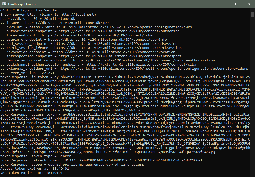

The sample asks for an XProtect VMS server URL, and defaults to
http://localhost if none is entered.
The sample then proceeds through all above steps, and writes information to the console.
