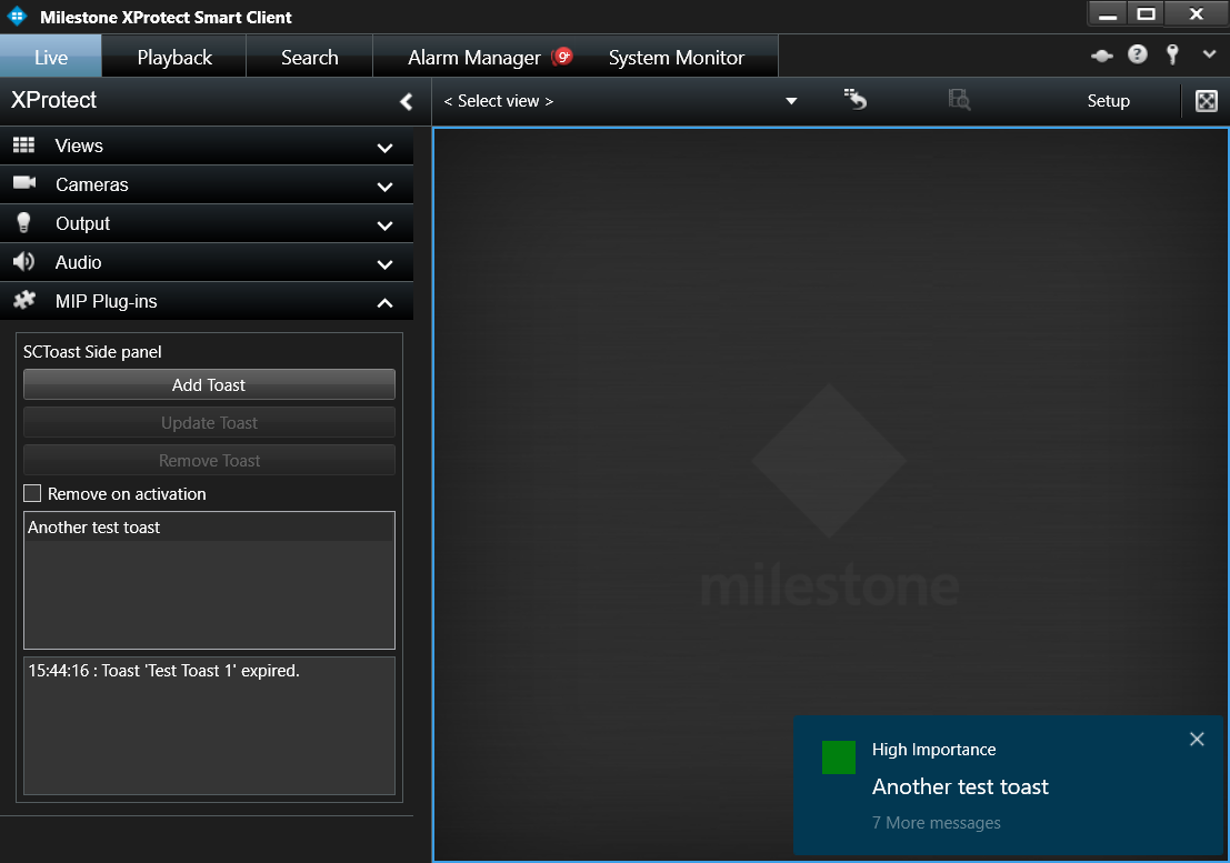

Smart Client Toast Sample
This sample shows how to use the Toast functionality available in MIP. The sample consists of a Smart Client side panel plugin that allows creating, updating and removing toasts. Toast related callbacks from the environment is also indicated by the side panel.
The sample UI is displayed as a side panel plug-in in the Smart Client, where toasts can be created, updated and removed.
The sample demonstrates
- How to create, update and remove toasts using a plug-in running in the Smart Client.
- How to receive callbacks when the user interacts with a displayed toast.
Using
- VideoOS.Platform.Messaging.MessageId.SmartClient.ToastShowCommand
- VideoOS.Platform.Messaging.MessageId.SmartClient.ToastHideCommand
- VideoOS.Platform.Messaging.SmartClientToastData
- VideoOS.Platform.Messaging.SmartClientTextToastData
