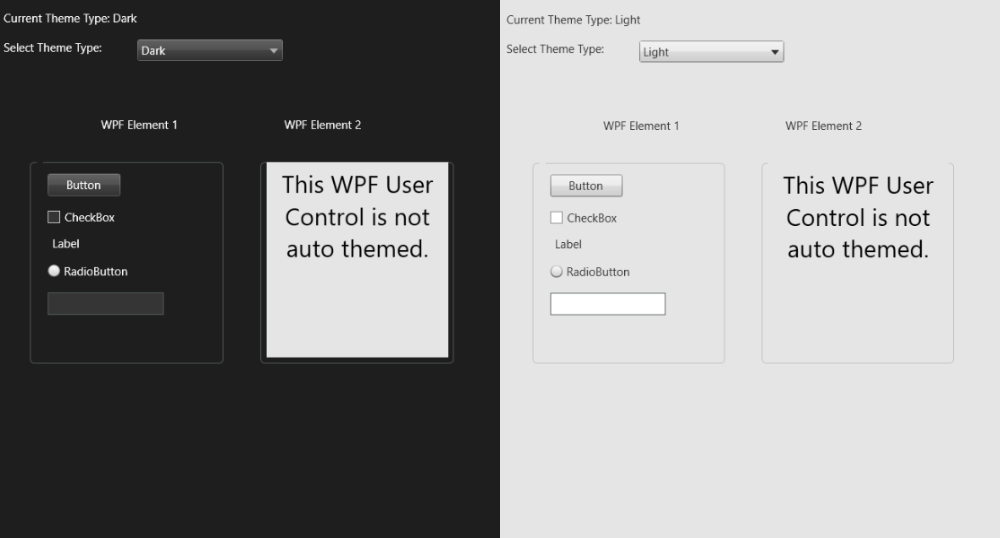

The SCTheme sample illustrates how the appearance of user controls change when a theme is applied.
The sample also demonstrates how a MIP plug-in can change the selected theme.
WPF Element 2 will not be adjusted by any theme changes, while the appearance of the rest of the sample will change depending on the theme. The sample will be themed during initialization and when the user toggles the theme selection button on the top, or via the theme select dropdown in this sample.
