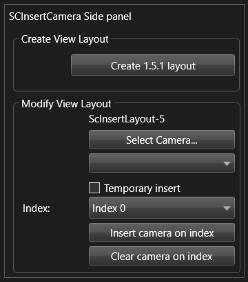

The above side panel is displayed when the Smart Client is in live mode.

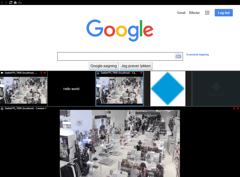

Select the "Create 1x5x1" button to create a view layout with a HTML page containing the main Google web page, a view item with the first found camera, a text view item, a carrousel view item, an image view item, one empty view item, and a hotspot view item.
The "Select camera..." button is used to select a new camera, and the "Index xx" drop-down is used to select what position/index the selected camera should be inserted on.
Select the "Insert camera on index" button to replace the camera view item at the defined index with a camera view item containing the selected camera. If the "Temporary insert” checkbox is checked, just the camera id is replaced temporarily - and therefore not saved on the server. Note that only camera view items can be replaced in this way, other view items cannot.
Select the "Clear camera on index" button to place the CameraViewItem in an empty state - ready to be filled with a camera later.
