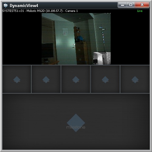

Each time an alarm is selected in the alarm list, a MIP message is sent within the Smart Client, to notify all plug-ins about the new alarm being selected. To see the dynamic view, you need to have a an alarm list which sends messages.
This sample creates a new view in a floating window when a message is received.
The sample listens on a message issued by the Event.Platform plugin when the user selects an alarm.

The sample demonstrates
- How to receive MIP messages from the Alarm List plug-in
- How to create temporary views and view groups
- How to create floating windows
