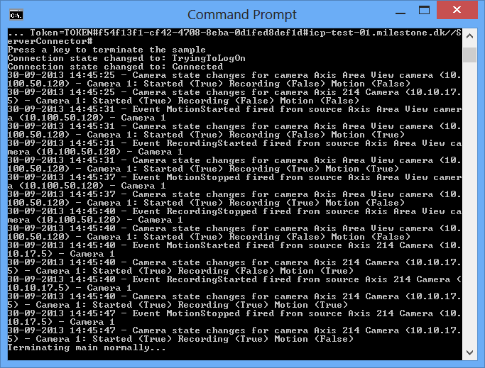

When connecting to this recorder, the application will create a list of all events and cameras for any event from or relating to any of these.
The application will dump any state changes and events that occur while the application is running.
