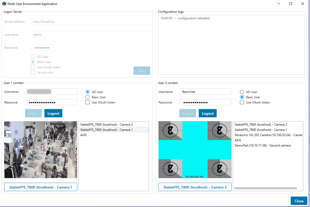

In this application, you first initialize the environment with the
selected XProtect server.
Afterwards, you can log in as two different users to the defined
server.
Login can be performed as an Active Directory (AD) user, a basic user,
or an external provider user.
After a user logs in, the list of cameras accessible to that user is
displayed in a list box. If the server is part of a Milestone Federated
Architecture hierarchy,
cameras from child sites will also be listed. The user can also select a
camera and view the live video stream from that camera.

The sample demonstrates
- How a single instance of the .NET Library can hold multiple users' configuration at one time
- Login with AD and basic users with OAuth tokens or legacy functionality
- Login with users authenticated through external identity providers
