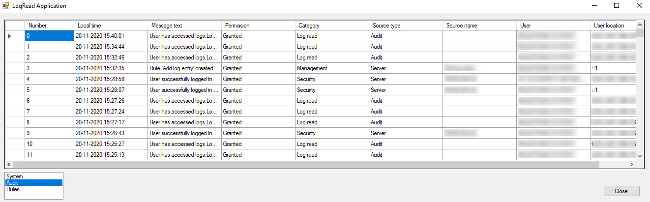

Logs saved to XProtect VMS system are grouped into log groups. This sample shows how to read those groups from the server and how to read logs from a specific group.
When application starts, log groups are loaded from the server. Once the group is selected, log entries from the log group are displayed in the grid.
