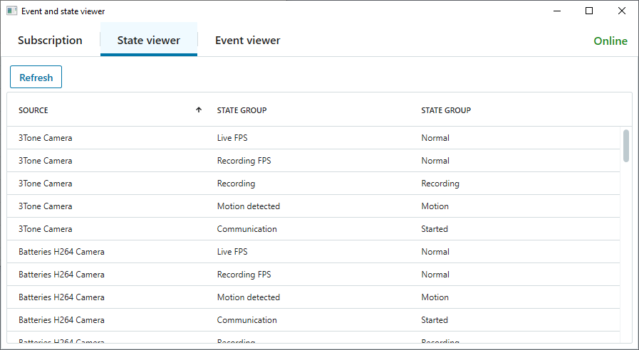

- State viewer
- Contains local representation of the state matching the current subscription
- The state is updated when stateful events are received
- Names of events, state, and state groups are looked up using the Configuration REST API
