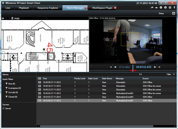

- Set up an analytics event named MyAnalyticsEvent01 in your XProtect Management Client
- Setup an alarm that is created based on the analytics event (the name configured above)
- Start the sample, login to the XProtect Server, select a camera from
the system as event source, and hit the "Send analytics event" button.
- Note: The Analytics event name must match a name you have configured in the Management Client
- Use the Smart Client Alarm Manager tab to see the Alarm in the Alarm List.
- Switch the Smart Client alarm list to show events and see the event. (You can omit step 2 and 4 if you would like to use analytics event without using alarms.)
