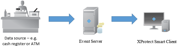

Transact enables reception of transaction data which is stored in the database. The transaction data can be browsed and searched in XProtect Smart Client in combination with video.
Transact connectors are the components that determine how a Transact source acquires the transaction data. This could be through a network, other cable connections, or simply from files on a disk.
Ideally connectors do not interpret the data in any way, but simply pass it on to the Transact system which interprets it according to a transaction definition. The definition is configured by the administrator.
