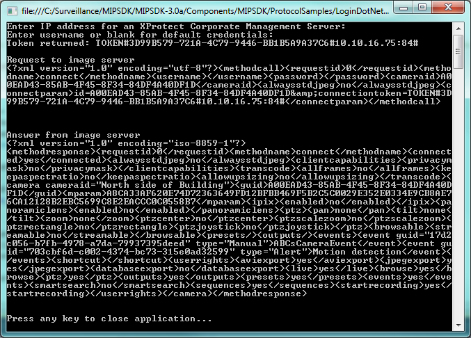

This sample shows how a minimal part of the ServerCommmandService SOAP proxy can be implemented for performing a logon to an XProtect system.
After the login is successful, it will connect to one camera and display the result on the console.
Please note that the sample is using a hardcoded GUID to identify a camera, as well as the recording server port.
MIP Environment - Protocol
The readable part of the protocol communication is displayed in the console window.
The sample demonstrates
- Use of ServerCommandService for performing login
- Formatting of XML on the ImageServer protocol.
