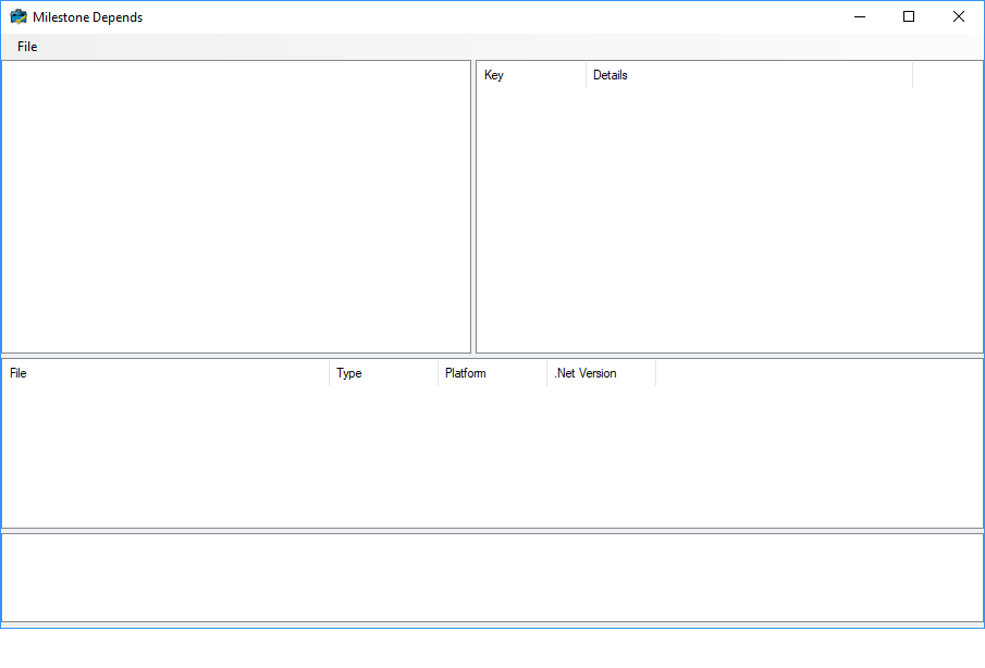

To start the Milestone Depends utility, double-click the MDepends.exe file. The Milestone Depends utility appears.

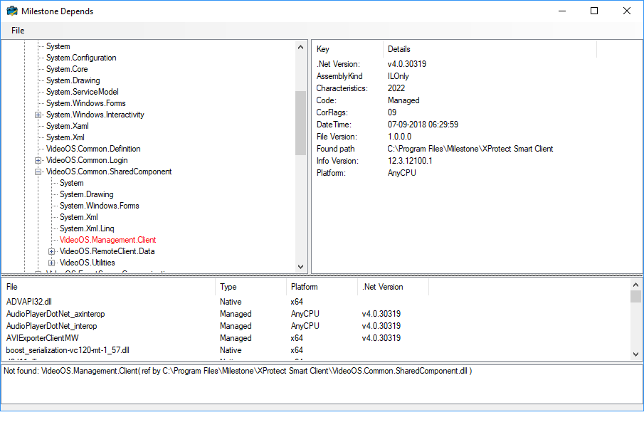

To investigate a Windows module, in the Milestone Depends utility, select File > Open and navigate to the module that you want to investigate.
Milestone Depends scans any 32-bit or 64-bit Windows module (exe or dll) which the selected file is dependent upon, and builds a hierarchical tree diagram of all dependent modules. Exceptions, such as missing files, are listed in red.
Another view displays detailed information about each file including a full path to the file, version numbers, platform, and more.
The middle pane shows a flat structure of the system, where you can view the type, platform and .Net version of each file.
The bottom pane lists all of the exceptions.
